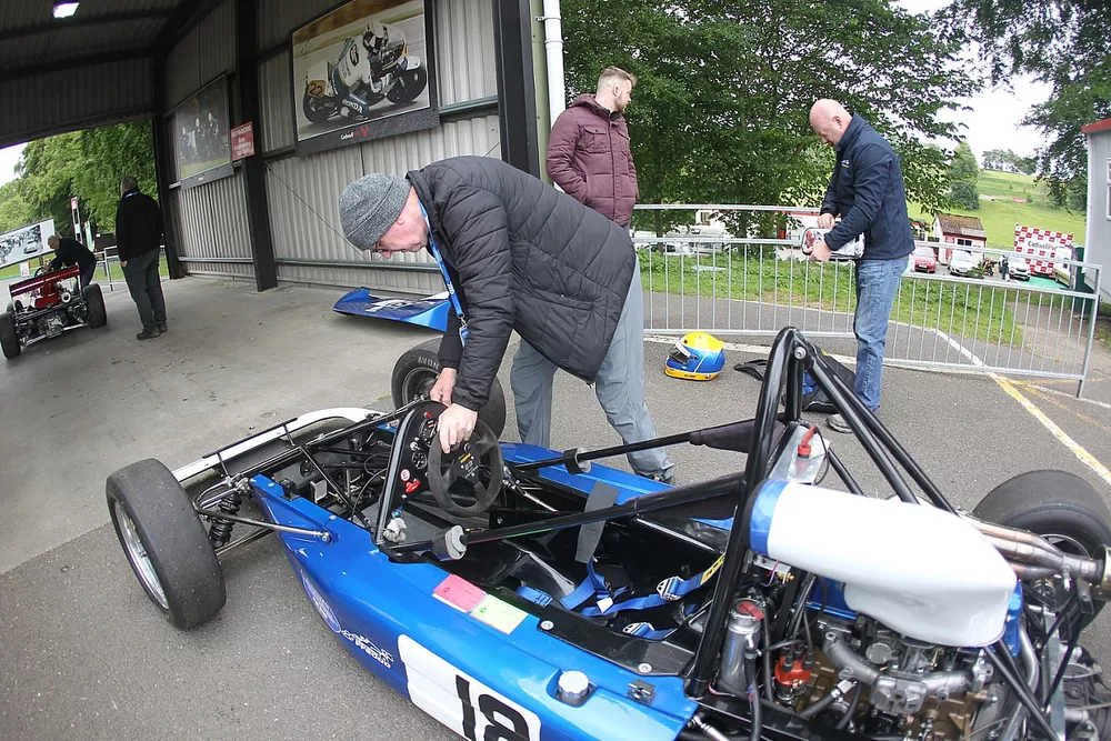

Atmosphere at scrutineering bay

“The opportunity for competitors to interact with the scrutineer was missed and something that there’s a strong push to maintain,” Ian Smith, technical director of British governing body Motorsport UK, notes as one example.
“There was also the perception that the standard of preparation of vehicles had dropped during the period where scrutineering was self-declared. So, there was a survey put to the scrutineering community at the end of last year to tell us about their experience of working on the restart of motorsport under COVID restrictions and asking, ‘Do you believe we should go back to scrutineering as it was before or do you believe there was enough learning through this process that warrants further investigation to continue the development of the scrutineering process?’”
The consensus was that a permanent change should be considered and therefore a trial looking at the future of scrutineering has been put in place for this year. While the standard approach is that clubs go back to the pre-pandemic system of scrutineering every single car before it heads out on track, organisers were able to sign up to be part of a Motorsport UK pilot scheme. Under this, 25% of entrants at a meeting would be subjected to a longer, more extensive check before an event – with the intention of therefore being seen once every four fixtures – while the rest just complete the self-declaration.
“The team set up a working group, which has got an interesting cross-section of stakeholders in it,” explains Smith, who joined Motorsport UK just as the trial was beginning. “There’s obviously some experienced scrutineers, there’s also some scrutineers who in their responses to the survey said, ‘Do you know what, no, I think we should go back to how we did it before’, and it was felt important that people who represented that view were part of this as well.

Seven clubs opted to participate in the trial and, in the first three months of the season, a total of 26 circuit racing events were conducted under this system of more intensively scrutineering 25% of participants. Among those involved is the Classic Sports Car Club, and director David Smitheram believes there are some clear benefits of the revised format.
“The biggest upside is it’s so much better for everyone – both scrutineers and competitors – as they don’t have to start their morning with a push to the scrutineering bay, so in that respect it’s great and we really hope it continues,” he says.
“In terms of the way we’re running it, some clubs are doing a random 25% of all grids but we’re doing two series per day. We’re doing two later on the timetable and they don’t have to get there at the crack of dawn. Then, every car, when it goes into the assembly area, has basic checks – brake lights, visual checks of tyres.
“We’re trying to get that balance between safety and recognising it’s a customer-based sport. Safety is important but we have to recognise time is precious. Without those 7am starts for many, it means people are able to spend Friday night at home with their families – we’ve really noticed the difference in the paddock on Fridays, it’s not as busy as it once was.”
"The objective mustn’t be an exercise in finding ‘What can I fail someone on?’" David Smitheram
But, despite the advantages of the new system, Smitheram says there are still elements that need a little refining. Chiefly, he wants to ensure that the more detailed checks – lasting 15 minutes, compared to the standard six – address the right areas.
“What we don’t want to do is tell scrutineers, ‘You’ve got 15 minutes, go to town’,” he says. “The objective mustn’t be an exercise in finding ‘What can I fail someone on?’. What we don’t want is it being a formulaic checklist and competitors know they only need to check these eight things.”
